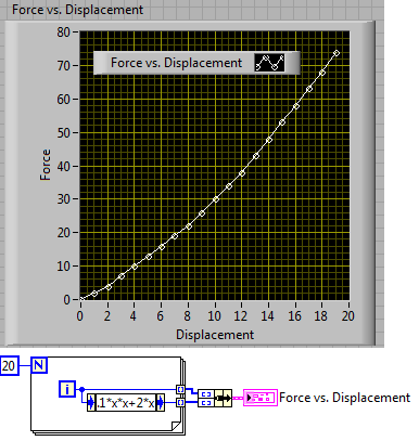

How do I plot two variables when neither are time?
I know how to plot a variable against time, but how do I plot two variables when neither one of them are time against each other. For example if I want to plot say force against distance what is the best approach to use?

Use an XY graph. Use Context Help to see the expected datatype, and refer to examples. Consider the following, remembering to rename the Scale Labels and Plot Name:
19919iF6CC6FDC0CA066FA
