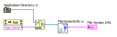

Set the desired version number in the build specification and use vi.lib\Platform\fileVersionInfo.llb\FileVersionInfo.vi to get the version from your exe. Following code should work:
