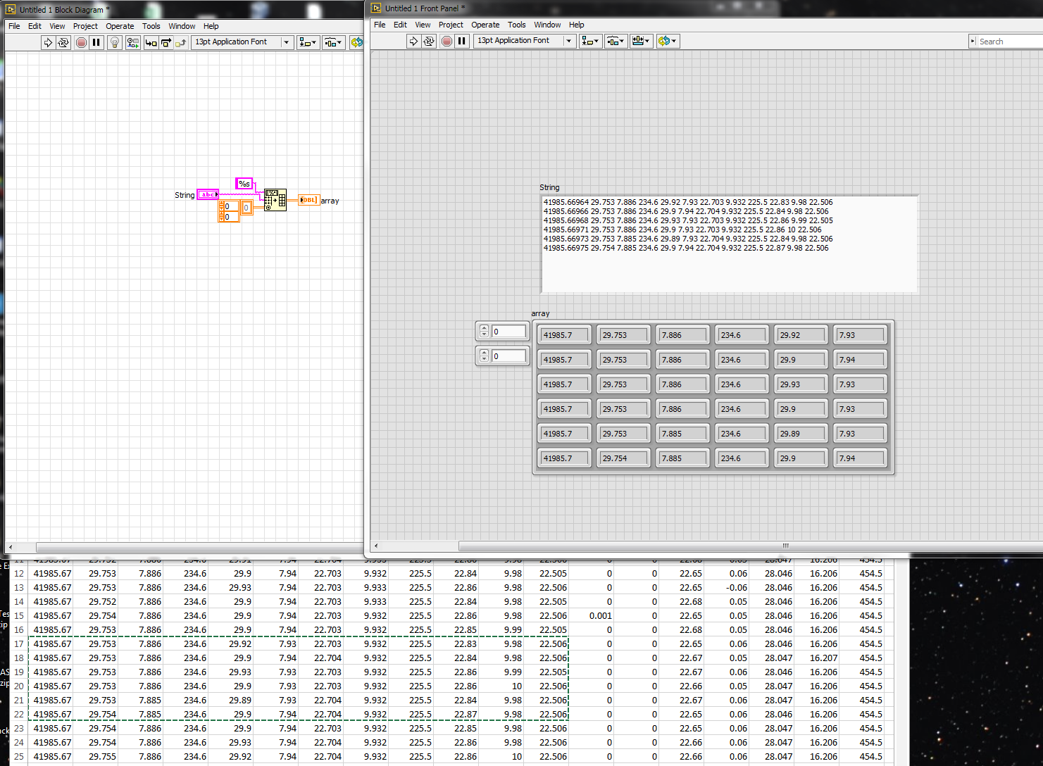

If you want to manually copy an area from an Excel spreadsheet and paste it into a Labview program then that is easy
Just use a string conrol and Spreadsheet string to array
Then just copy the section from Excel and paste it into the string control (Use Ctl+V to paste)

RTSLVU solution is simple and easy to implement if you accept to do the copy paste operations "manually" after you have selected a range in Excel.
