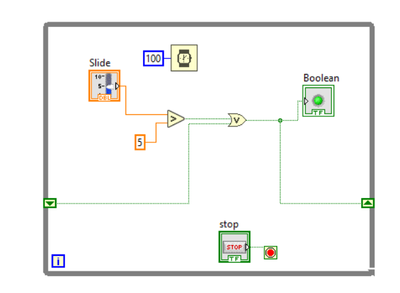

Keep the previous value in a shift register (initialized with FALSE) and OR that with the comparison result. The output goes back to the shift register.

I made a quick simple program to see if I could get a Boolean switch to turn on and off every time I went above a threshold of 5 with a slide controller. I must not understand your explanation completely because I can only get the switch to stay on and not turn off again.

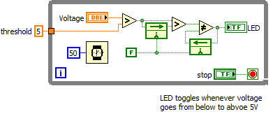

Hi Math,
try this:

Ah sorry, I did not completely understand your requirements. What is "stays "either" true". Is there an "or" somewhere?
My suggestion will stay true forever. Don't forget to initialize the shift register.

Here's an alternative, pretty similar.
