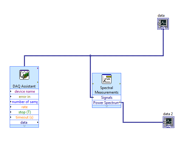

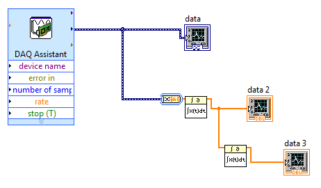

I have a a couple of simple programs to capture signals from two piezo sensors. One is an accelerometer, the other is a force transducer. I would like to be able to control the start of the capture by using the output of the sensor and set a timer to stop. I have almost no experience with LabView software so I have not been able to figure this out on my own. I would be grateful if someone can help me do this.

Thanks for replying. Let me try and better explain what I am attempting to do. I am helping a high school student who is conducting an experiment involving a spring mass system. The experiment looks like this. There is a weight that is guided on a rod. There is a spring also guided on the rod that the weight rests on initially. There is a piezo force transducer on the bottom of the rod. If the weight is lifted and released, the LabView VI captures the voltage signal from the piezo as the weight bounces up and down on the spring. It is difficult to capture the initial part of the cycle each time because the person dropping the weigh also has to hit the run button so the timing is inconsistent and the first cycle some times gets missed.
I am hoping the process can be automated so the capture can begin and end automatically. I would like the LabView application to start (same as hitting the run button) capturing the data as soon as the weight contacts the spring and the sensor starts to generate an output voltage. I would like this to happen without having to manually hit the run button. I would also like to have the ability to specify the time when the application stops capturing data so I can control how many cycles are measured.
