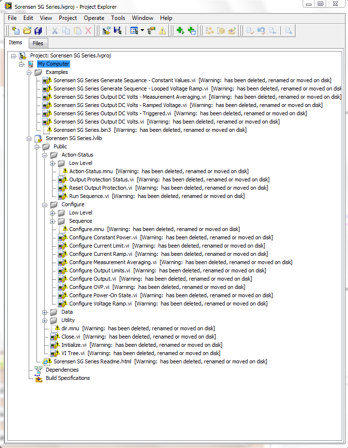

For instancwe today I am pressed for time to get a test running I download a project type driver for a dc source from NI
http://sine.ni.com/apps/utf8/niid_web_display.model_page?p_model_id=7771
When I open it this is what I get all the files are missing and I have to hunt them down one by one and fix all the flags.

You aren't paying attention to the instructions on the download page or you aren't using the Help> Find Instrument Drivers. You simply have to place them in the correct instr.lib folder.
