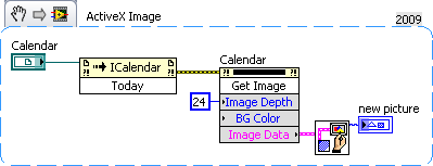

How do I write a control to an image?
I have an ActiveX control pulling data from another program, which displays an image from a camera. I was wondering if it is possible to write what is displayed in the ActiveX container to an image file?

You can use the Get Image Method of your ActiveX container to get the image data.  Here I draw a picture, you can also pass the image data to the save to BMP/JPG/PNG VIs.
