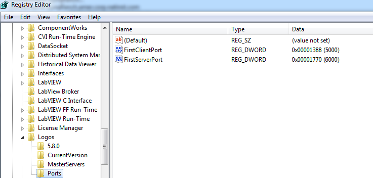

The location hasn't changed. It's possible that the actual registry keys don't exist in a default install of LabVIEW. In that case, you can simply create them yourself. It should look like this:
Also, be aware that 64-bit Windows maintains separate entries for 64-bit and 32-bit processes.
HKLM\Software\National Instruments\Logos\Ports
Will modify 64-bit apps. You most likely want:
HKLM\Software\Wow6432Node\National Instruments\Logos\Ports
Which will modify 32-bit processes.
