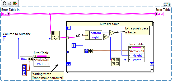

Hi
I liked Ben's approach. Attached VI and snippet.
Message 7 of 8
(5,252 Views)
I wanted something a little different.  Here's what I came up with,
Message 8 of 8
