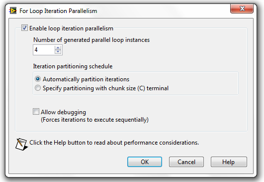

Hi all,
How iteration parallelism it's works?
Can anyone give brief explanation about it?
02-05-2018 01:45 AM
The parallel instances terminal specifies the number of loop instances LabVIEW uses to run parallel loop iterations. If you leave the input of the parallel instances terminal unwired, LabVIEW automatically detects the number of logical processors in the machine and uses it as the default parallel instances terminal value.
You can use the input of the parallel instances terminal and the Number of generated parallel loop instances in the For Loop Iteration Parallelism dialog box to improve For Loop performance by oversubscribing or undersubscribing.
/Y

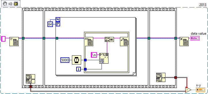

To me it's weird that this parallelism is so much tight to the CPU. After all, we can start thousands of parallel VI's dynamically. Automatic parallelism like that is one of LV's favourite features. When you want absolute top notch performance, the CPU link makes sense. However, shouldn't there be an option to tell the for loop to simply start the loops in parallel? Or better: shouldn't LabVIEW be able to detect that?
Here (Support-more-parallel-instances-in-the-parallel-FOR-loop) you describe the use case of simply starting things in parallel. OO is perfect for that, you can simply call object methods and they magically run in parallel. However, the 64 is an artificial limit in that case. It simply does not make sense (from a user PoV). Why is it there?
One of the replies suggest that the limit is needed for nested loops. So I figured an inner loop at 64 parallel instances nested in one with 2 would give me 128 parallel processes. However, LabVIEW (2013) has problems compiling that. It's a memory bomb. Even when values of N and P are given dynamically, LabVIEW hangs the entire system (mouse, sound etc.) and builds up memory until at least GB's (did not wait for it). At some point task manager can get between the CPU and you can kill LV...For loop snippet.png
There is absolutely no reason why LV can't perform the loop more then 256 times in parallel. As a proof, you can copy the for loop above 5 times... Execution time is still 5 seconds (even with the unchanged 64 limit).
It's really sad LabVIEW doesn't simply deal with it. I'll deal with the "overhead"...

I just don't get the limit at all... The CPU nr. of cores just doesn't make sense. Other threads are already occupying an arbitrary nr. of cores\threads\whatever. Not saying there's not a good reason, I just don't see one.
All workload is divided in chunks. Max. 64. But When I copy a 64 loops 10 times, I can execute 640 chunks in parallel. So why the limit?
Have to talk to someone at NI about this... Maybe next week at the CLA summit. If I remember to do it (there will be self inflicted beer trauma and not enough sleep), I'll post my findings.
BTW1. The configuration UI limits the nr. to 64. But you can wire anything to the "P" on the diagram. However, only 64 iterations will be executed in parallel. So wiring 65 in my little example, will take 10 seconds. 5 seconds for the first 64, 5 seconds for the 65th.
BTW2. Posted a link to this thread on the idea exchange idea.

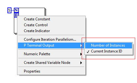

It came up during the CLA summit. The "compiler team" also did not have an answer ready. I forgot about the question, but got an answer by email just now...
The for loop actually creates parallel instances, and because this consumes memory, a limit seemed reasonable\desirable. 64 is just an arbitrary "not too large, not too small" limit. It's not related to nr. of cores, threads or whatsoever...
Adding "ParallelLoop.MaxNumLoopInstances=10000000" to LabVIEW.ini virtually removes any limit.
02-28-2018 09:48 AM
Sadly, ParallelLoop.MaxNumLoopInstances is read once, and then stored internally. Using LV Config Write Numeric (I32).vi changes the ini file, but sadly the old value is used in for loops... So a restart is needed.
