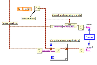

I can confirm that yes, the Attributes field of Build Waveform accepts the variant that holds all of the Waveform's attributes. And while you can get some of the same functionality from a Map, the variant attributes are useful as you can use a mixture of datatypes, and you can handle the attributes using either the Waveform attribute functions or the Variant attribute functions identically*:
Note that the following code segments are identical:
(Note that both "Read waveform attribute" and "Read variant attribute" will return ALL attributes if you don't wire the "name" input).
*There could be performance differences between the two versions but I've never checked. Generally these things are very fast, and I'd guess it just comes down to being prudent with memory copies. As far as just functionality, the two ways to access the attributes get you the same thing, just using different methods.
