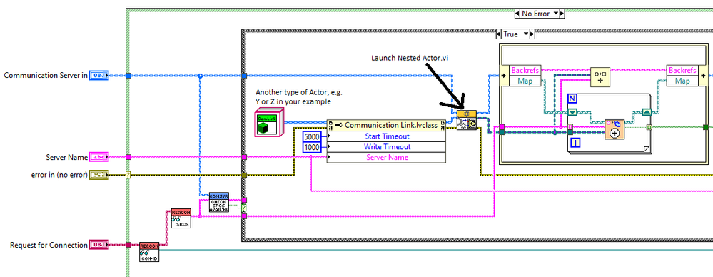

Here's an image from a VI I have as a member of an Actor that uses Launch Nested Actor to create nested actors.
These are like the Y and Z in your example.
Here I use Maps and Sets (and the Registration Map code from the Collections palette) from LabVIEW 2019 to store a set of enqueuers (because these are launched dynamically).
If you don't need dynamic launching, then you could instead use something like Bundle by Name and just store the enqueuers with a specific name in the private data of the X.lvclass, as prettypwnie already described. Then, unbundle when you need to send it a message using "Send Do This.vi" or whatever.
Here I look in the Map for the specific data source's enqueuers, and then send the "Result" object to each of the enqueuers that are registered for that source. Again, I used the Map because I don't know ahead of time how many things might care about this specific source, given here by "Source Name".
