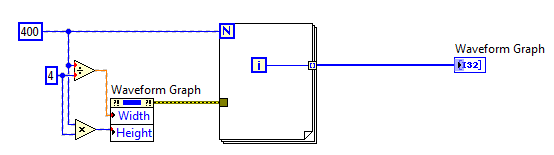

How does waveform graph downsamples the data before it is plotted
Oddly, i cannot post a VI here, so here the screenshot of the code:
You will see that several values of the plot are drawn on the same x-coordinate.

Andrej,
I don't think the waveform graph is downsampling. It either plots everything and x-values get rounded according to the available resolution or it plots minimum and maximum value inside each bin of available x-increments.
This way you don't miss events in your waveform
Cheers
Edgar
Edit: and Norbert just confirmed that it plots everthing!

Accepted by topic author andrej
Here http://digital.ni.com/public.nsf/allkb/F694FFEEA0ACF282862576020075F784 is the answer - LabVIEW uses a max-min decimation algorithm to display data on a graph 🙂
