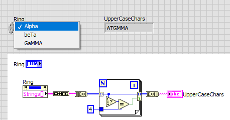

  • Convert string to byte array
  • Autoindex on a FOR loop
  • Use a conditional output tunnel that is true if the byte has lexical class=4
  • Convert byte array to string

The Ring Property Node could be for either Ring 1 or Ring 2

Hi @ @PalanivelThiruvenkadam, @altenbach, @Minions,
Thanks you for your reply.
Thats works now what I want.
Have a good day 🙂

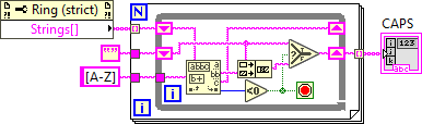

I still recommend the lexical class solution. Arguably significantly simpler:
Here's the code for one Ring. It would be easy to expand to two, of course.
(concatenate strings turns the array of strings into a single string).

Hi @altenbach,
Thank you for your reply.
Yes I agree it's  significantly simpler.
I learn a lot in this forum, you're all great 🙂
