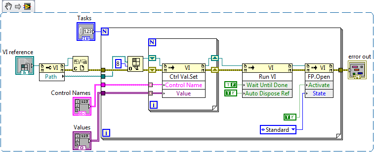

In this method how does the parent method give the control back to top level caller vi?
When the parent method started the reference dynamically, it continuous execution (Set wait to false). The started VI is running in parallel.
