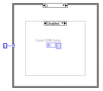

Hi, Kimdino,
I don't think so, and you can perform simple test yourself. For example, if you will put such construction on your block diagram:
and then build the application, then you will get constant in your builded application (but this constant is not connected, isolated with case, and disabled with disable structure).
regards,
Andrey.

Andrey,
how and in which LabVIEW version did you tested this?
Ton

Hi, Ton,
LabVIEW 8.5
Test project  in the attachment. That was a quick test, probably something wrong. Anyway without constant - size of the executable is small, and wit unused constant increased.
