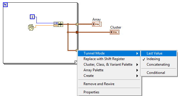

Since a few days i started working with LabView. Now, i have a very simple algorithm that i don't understand:
 170913074112-170912_Test01_MainVI.vi Block Diagram on 170912 Test01.lvproj_My Computer _.png170913074215-170912_Test01_MainVI.vi Front Panel on 170912 Test01.lvproj_My Computer _.png
Why do i see the curve in the XY-Graph ???
My expectation was to see only the last point after the loop has been finished. Can somebody explain this to me?

I strongly recommend to take the free tutorials. Even better, if you have licence, take the Core 1 online self-paced training.
Your post title is a bit misleading, the Bundle function has nothing to do with that you see here. It is simply the autoindexing feature of loops, which is very useful. You can also get only the last value, you can select other options by right clicking on the "border node":

Oh yes, its quite simple, if you know. Thx very much.
But its diffcult to find the right answer, when i don't know the right keyword...
