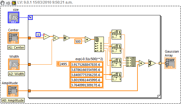

If you still need a further speed increase, it's also worth looking at what computations are expensive in your loop - in your case it will be the "exp" function that costs the most time, and the argument of the exponential is always in the same range (0 to -10 or so).  One way of speeding that up would be to replace the Exponential computation with a lookup table - i.e. precompute the exponentials and then interpolate the result from the stored array, rather than compute it each time.  I get a speedup of another 50% using a 2500 element table, with approximation errors < 10^-6.  The speedup will be even more pronounced as your problem gets "larger" - i.e. if you have more Gaussians, or more points in your spectrum.

That is a brilliant idea - I like it.  I don't quite grok the x500 (in the calculation) and the /500 (in the formula for the lookup table).  Still - that is sweet - and I may not need it to be even that accurate.
Thanks for showing me how to implement it without an inner loop, as well.

The /500 and x500 is to map between the input number ("x") and the lookup table index - i.e. each lookup table value maps to a change in "x" of 0.002 (1/500).  That could easily be any other mapping depending on how big you want your lookup table to be.  By the way, the Interpolate 1D Array function has the capability of defining the lookup table using an array of clusters, where the cluster includes both the x value and its result - however this turns out to be at least a hundred times slower!
