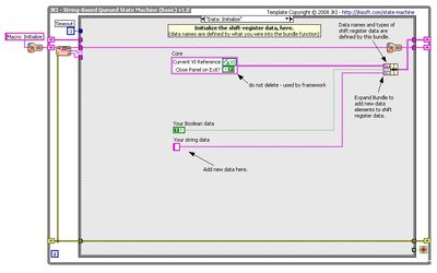

I'm curious as to how many you think you need if you're concerned about how many you can have!  A hint to make your code more readable is to cluster all your data and pass them through a single (or, a couple) Shift Registers; the JKI State Machine does this.  You'll bundle all of your elements in the Data: Initialize state.  I've done the bundling in a subVI because I had too many elements to fit cleanly on one screen.
