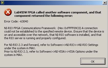

I using cRIO 9012 and NI 9233 .When i everytime run the same error will appear .I dont
know whats the reson.As u say earlier i go through discussions fomrs but one thing i dont
understand is how to reformatting cRIO 9012? Can u suggest me some idea?

yah. Its same IP address in my project and MAX .
ERROR: -63040
NI-RIO FPGA Communications Framework: (Hex 0xFFFF09C0) A connection could not be established to the cspecified remote device. Ensure the device is on and accessible via the network and that it is listening on the correct port."
Can u suggest me how do i fix it?
