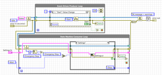

I have been following Paolo's example on Producer and Consumer (see snippet and link).

1) Best practices for creating DAQmx Input and Output in Consumer Loops? If SubVi is suggested, how to best create one? If not, how to break the DAQmx operations efficiently in the state-machines?
----- In my previous attempt, I have over 40+ states. I have also broken the start, read/write, and stop of each task in the states. I created and cleared the task outside. However, it became hard for me to loop through different settings (i.e. different amplitudes/frequencies/numeric controls) if I, for example, were to input in a text files with over 10+ settings sets. It was my intention to keep the program simple but still robust and efficient, but due to my lack of experience... the program just grew!

I won't claim these to be *best* practices, just sharing some thoughts that I've found to work out fairly well.
I largely gravitate toward a Queued Msg Handler structure with one "main brain" loop that coordinates several other dependent Msg Handler loops while receiving data from them.  These auxillary msg handling loops tend to be built around on a specific instrument or logical grouping of devices.  I try to design them to have a relatively simple messaging API and give them internal smarts & independence.
My starting point would imagine one msg handling loop for the Stepper Motor API and a separate one for the Robotic Arm API.  That's not a hard rule though, you may find it easier to coordinate their sequential operations by putting them in the same loop and carefully designing both your messaging API and the internal "state variables" to work closely together.   A similar idea holds for the buffered AO and AI DAQmx tasks.  I initially imagine them as separate loops, but it may be easier to manage their coordination if you put them in the same loop.
Now, on to your specific questions:
1. 40 states is not trivial to organize and manage.  Consider whether there are cases where you can combine a sequence of states into a single subvi instead.   If you want to work through many distinct config sets, you should have "states" or "message cases" inside the main loop that can handle the needed task config and de-config.
2.  I make subvi's either to package functionality for reuse, or to save block diagram space (possibly to help clarify a sequence of higher-level operations).
3. I make data acq loops that are responsible for publishing their data back to the "main brain" loop.  The main brain can process, display, or repackage it for a data logging loop.  I wouldn't argue against sending data direct from the data acq loop to the data logging loop though.
   As to the async stuff, that all works very nicely with the QMH structure.   The "main brain" can receive any info whenever it happens to arrive, then uses it to decide what control messages it may now need to send to the auxillary loops.
There are times that a QMH loop and a parallel state machine loop on the same block diagram make a very useful combo.  You can get the responsiveness of a QMH along with the sequencing/logic/structure of a state machine.
