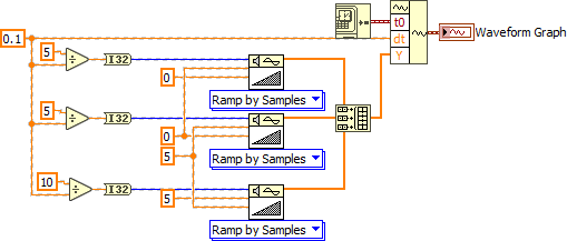

Dear Sir,
I created The VI as you told. But Do i Need To add these waveforms or any other Thing that i can do ?
Message 5 of 11
(8,694 Views)
Accepted by topic author prasad145
Hi prasad,
why do you create 3 waveforms when you only need one?
All those ramp parameters were different to your previous requirement…
Message 6 of 11
(8,687 Views)
