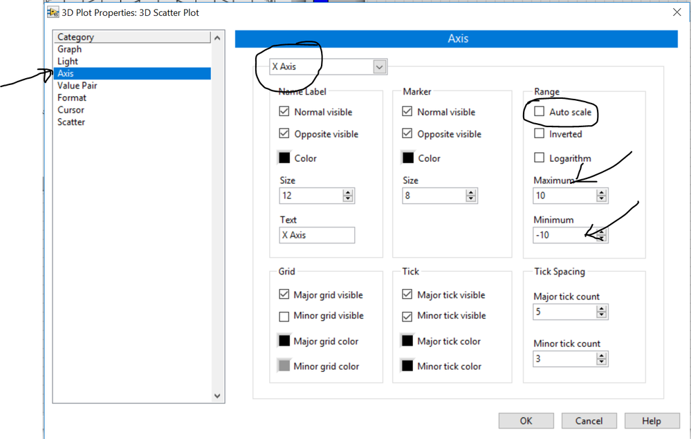

I have seen this issue before. It is to do with "Range Auto Scale" defaulting to +/- NaN when only one point exists.
If anyone from NI is watching, I would call this a bug.
In order to fix your problem, go to the 3D graph properties page and unselect Auto Scale and set a reasonable range for the Max and Min for each axis X,Y,Z.
Have fun.
