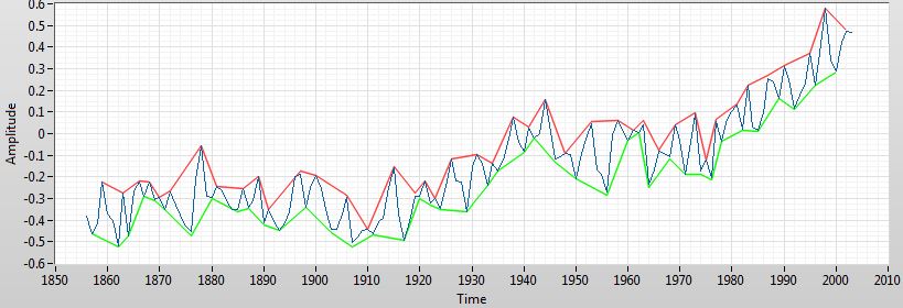

For this kind of signals I think its better to detect the peaks and valleys instead of using the Hilbert transform. Just in this case you will not get smooth waveform, but lines connecting the peaks/valleys.

I have attached the code with Peak/Valley detection part added. Just as I noted the envelope is not smooth, as the graph just connect the peaks/valleys with lines.

You will not get envelope for the current waveform with Hilbert Transform.
But using Peaks/Valleys you will be able to get something more similar to the envelope, as in the image below.

Sorry, im new in labview......can you share the code?i dun know how to conect the cluser(the pink wire)to the 1D array(the brown wire)..
Message 17 of 18
(2,434 Views)
Accepted by topic author Ying88827
Please find the code attached.
