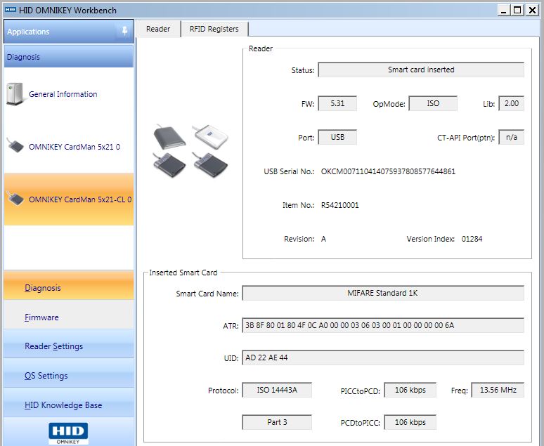

hardware used with card inserted using omnikey workbench:

From the image you have posted it seems it was a Mifare memory card which will just provide UID and not ATR (Both are different).
@Earl_M. wrote:
I used the code to start and check if i can get a return value.
So what you got? Any errors? Upto scardconnect function it will work and return UID. Let us know in detail what problems you face.

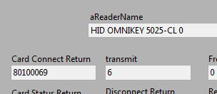

I get a return code of 80100069, i look for the meaning of it and below is the description the the return code.
SCARD_W_REMOVED_CARD
0x80100069
The smart card has been removed, so further communication is not possible.
and also the return code of scardstatus it "6" which is error_invalid_handle. Even if i placed the card on top of the reader. The same values i get if i remove the card.
