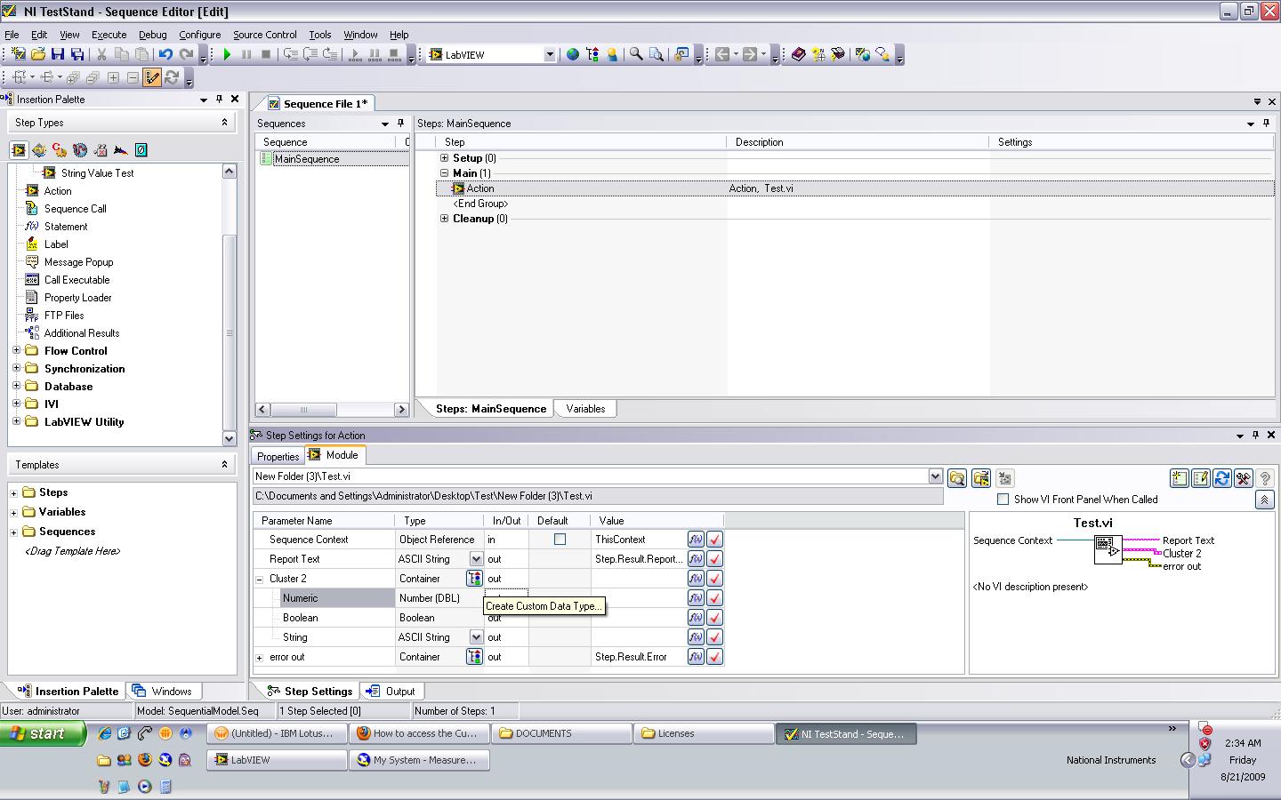

TestStand to LabVIEW: i didnt understand what you r trying to achieve. But if you are using references, Use Property nodes and Invoke nodes to achieve what you want in LabVIEW.
 LabVIEW to TestStand: check the image below: You need to click the button next to 'container'. I have used a cluster output in the VI.
Hope this helps
