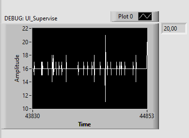

I set the loop time of my GUI to 16 ms, which should equal 60 fps if you do the math (1000 ms/60 = 16,67). However, I can't get stable 16 ms. It's jumping between 16 and 18 ms, causing all charts to stutter. Is there anything I could do to mitigate this?

- My method for measuring the loop time is attached

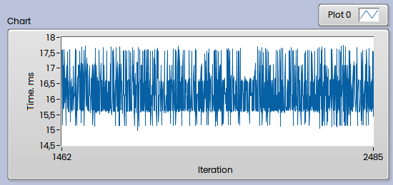

Still not sure about your use case behind, but probably you trying to achieve your "60 FPS" cycle with simple Wait (ms) function, something like this:
Now if you will measure exact sleep time (more or less exact, we're not in RealTime OS and please use High Res Seconds function instead of Tick Count ms), then something like that will be observed:
As stated in Help, Wait(ms) may give you real sleep 1 ms less than requested, but also you see a lot of spikes between 16 and 18 ms. It is so, because Wait (ms) uses standard Windows Timer, which have in LabVIEW 1 ms resolution. By the way, the default value of this timer is 15.625 ms (1,000 ms divided by 64), but LabVIEW will set it to 1 ms for you.

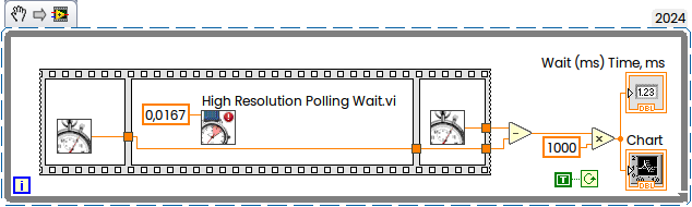

If you would like to get better accuracy, then instead of Wait (ms) you can use High Res Polling Wait:

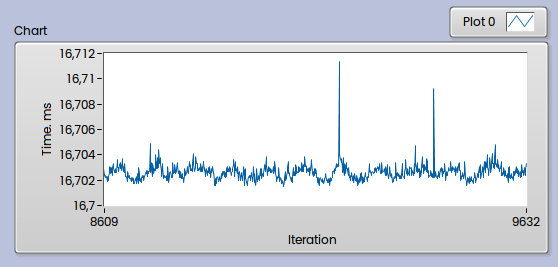

Then results will be much more accurate:

Here we still have some spikes, but overall deviation much smaller. But again, if you will have lot of parallel threads, and in additional background OS activities, then real "sleep" time may vary more and more. And you will get higher CPU load with this, which also sated in Help: "Unlike the Wait (ms) function, if the number of seconds you specify is 0, this VI does not force the current thread to yield control of the CPU. Use this VI with caution if you are concerned about high CPU loads: this VI may use polling to achieve high timing resolution for all or a portion of the wait time.".
