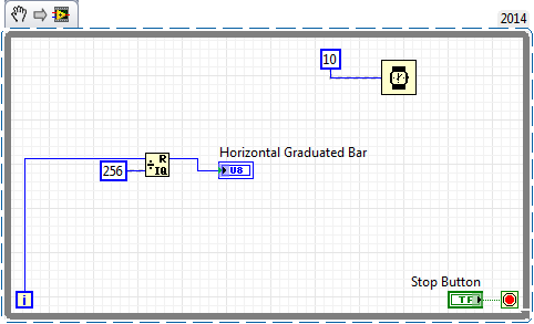

OK, Perhaps another thing you should consider.  A whole bunch of boolean scalar indicators might not be the "Best" way of displaying information to your users.
Just to get you thinking about other options, think on this codeSmiley Wink
That is a "Snipette" drag n drop to a blank LabVIEW Block Diagram and you can run the code.  (On some Windows Platforms you may have to drag to the desktop first then drag to the LabVIEW BD)
