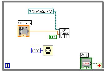

how to add time information to the first column of spreadsheet file?illustrated in the figure below。

You need to take the time data and convert it to double.  But Excel data is based on days since 1/1/1900 while LabVIEW data is based on seconds since 1/1/1904.
Take a look at this thread for an example I posted on how to make the conversion.
One other possibility is to convert your numeric data to a string, and build on an array of time that is also a string version of the timestamp.  Then write your 2-D string array to the Write to Spreadsheet file.
