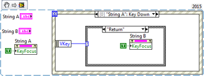

Hi Orta,
two ways:
1. Set a tabbing order for your front panel: now the user can change from control to control using the TAB key…
2. Use an event structure to wait for value change events of your string control(s): when an event occurs you can set the keyfocus for the next string control…
(4,171 Views)
It could be done.  The first question to ask yourself is "How do you want to set an "order" on the String Controls", i.e. given a bunch of Controls on the Front Panel, which is supposed to be "first", "second", etc.?  [One possible way would be to put them in a Cluster ...].
The next question is "What determines that the String has been "filled"?  One possibility is to make it a single-line String, so a <CR> ends it.
Now you can set up an Event Loop triggered by Value Changed for String Control 1, and get it to set the Focus to String Control 2 (and so on).
Bob Schor
(4,170 Views)
Accepted by topic author ShogunOrta
Have a deeper look into the Logic.
(4,167 Views)
