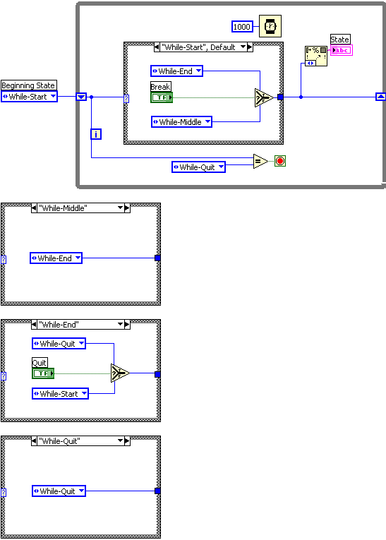

I have done something similiar to exit a test routine part of the way through a loop. I built my while-loop into a state machine and placed the "Break" into the states where I needed to break out the loop.
This example is a While-Loop with a start, middle and end section. The middle section can be skipped if the Break button is enabled.
I hope provides one idea on how to implement what you need
David
