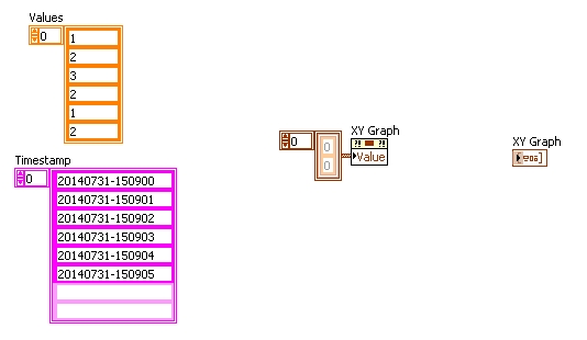

i have some data which is currently stored in two arrays. One array with values and another array with timestamps.
Now my questions is how can i bring/convert these into the format of XY-graph?
Thanks for help.

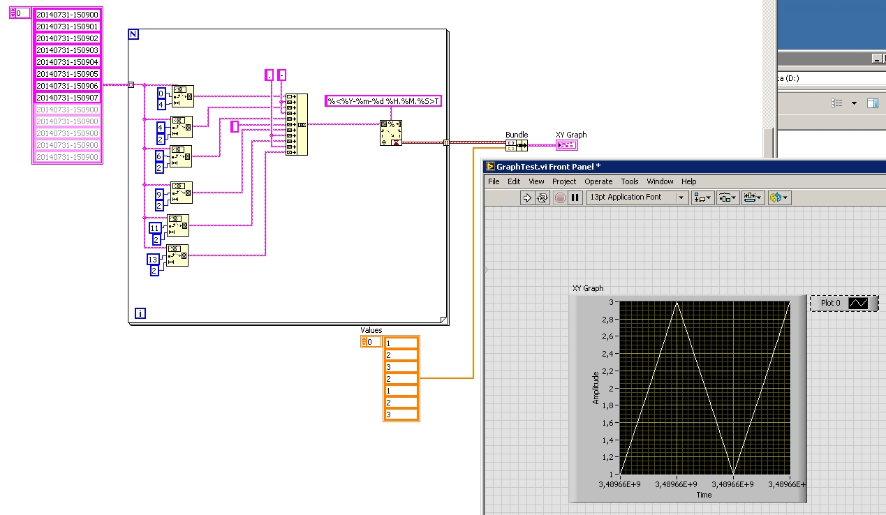

As shown in your picutre, the XY graph accepts a cluster.  Use the Bundle tool to place the X and Y arrays into a cluster

Your image shows an array of strings - not timestamps. You would need to convert that array before bundling. However, if you a regular time interval between samples, a normal graph makes more sense.

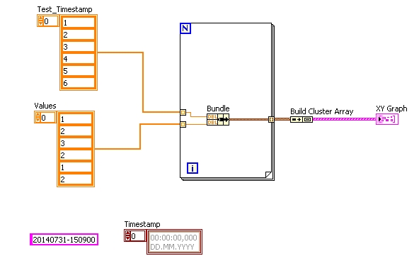

Is this the way how to convert the two arrays in xy-format?
Somehow i have to use the string-timestamp as i will have later 10 traces on the graph with little different timestamps.
Message 4 of 15
(4,685 Views)
That code makes no sense at all. You simple bundle the x and y arrays as you have already been told. Please turn on context help. When you move your mouse over the indicator on the block diagram, you will be shown exactly what is required. No for loop. No array to cluster. The bundle by itself creates a cluster.

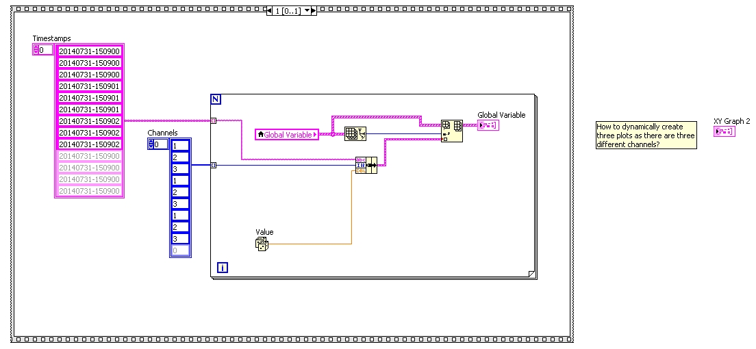

Currently i have a cluster-array in a global-variable
The cluster contains:
-Timestamp
-channel(1..30)
-y-value
I can have up to 30 plots in one diagramm.
Now i have to create something that depending on the number of different-channels in the cluster-array i have the same number of plots.
How can i do this?

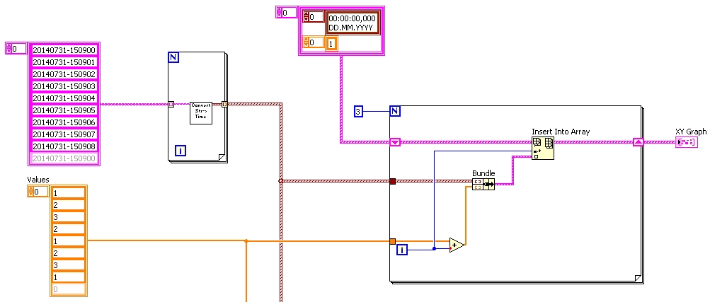

currently i am trying to use a loop that executes 3 times a Bundle and inserts it in a cluster-array.
The problem is that the "start-array" that goes into the shift-register is wrong at the end.
What can i change to not have this "dummy"-entry later in the array?
The loop inserts the correct values at index 0, 1, and 2 but at index 3 is then this dummy-array?
How to change this?
Thx
Message 9 of 15
(4,585 Views)
Hi One,
- Why do you use a InsertIntoArray when you want to append new plots to an array of plots? Use BuildArray!
- Why do you initialize your shift register to already contain (atleast) one plot?
- Why do you use a shift register at all? Why not rely on the autoindexing output tunnel? 3 iterations will yield 3 plots easily…
