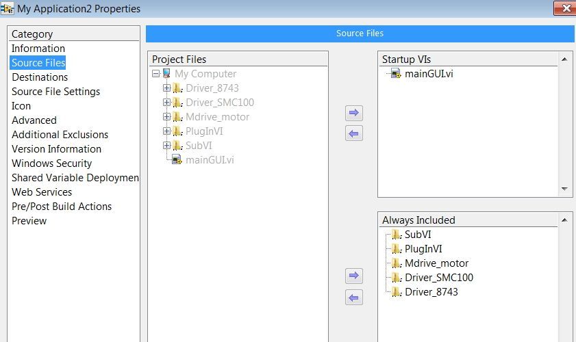

Thank you very much for your kindly reply. I tried to follow your suggestions but I failed to have the llb files. In fact, my concern is I want to share with my user the release without including any .vi files inside, for protecting source code purpose. Below is my project structure. mainGUI.vi is my main user interface. SubVI is sub vi used in main and PlugInVI contains VI provided by other developer and inserted into mainGUI. The other 3 folders are sub vi used in vi in PlugInVI folder.
Below is my steps on building .exe file. In this way, I need to put all folders, Driver_8743, PlugInVI, SubVI, etc., to directory of my .exe in order to run it properly. Is there a method that I can covert those folder into other format so that there is no .vi file appears in my .exe release package.

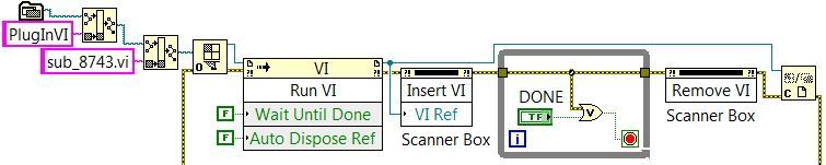

Folder PlugInVI contains sub VI created by other developer and the first 3 folders contain vis called internally in sub VI inside PlugInVI. Folder SubVI contains sub VI used in my mainGUI.vi. mainGUI.vi called those plug-in VI by using below method.

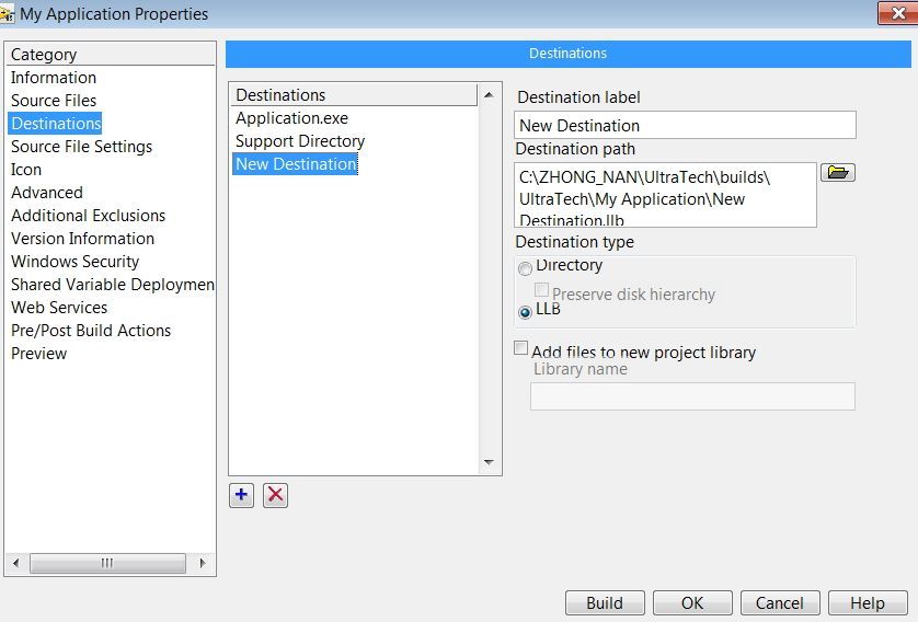

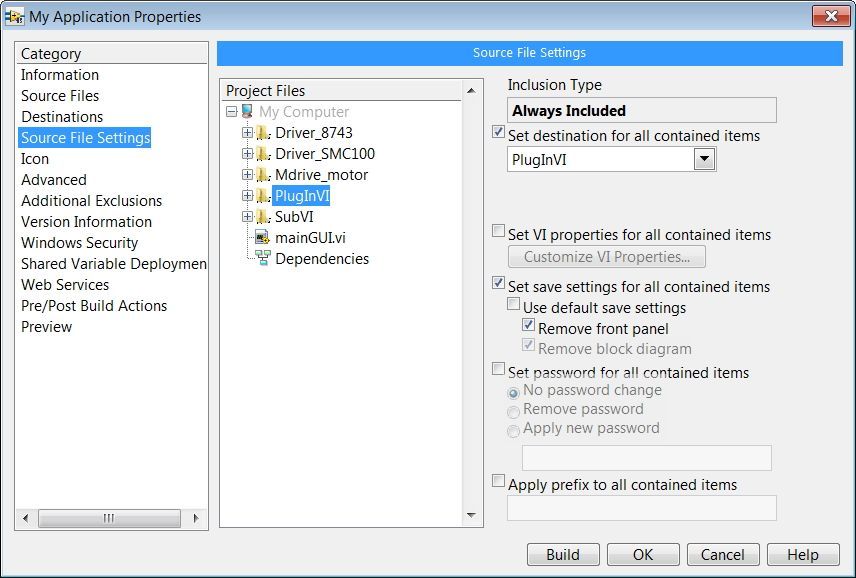

When you create the llb destination, go to Source file settings, there is a check boxes there for " Remove Front Panel" and "Remove Block Diagram", I always check remove block diagram option so that even you ship your VIs with your build, no body would be able to see the block diagram. You can also check remove front panel option as well so that your source code will definitely be double protected. I assume you have no other option then ship your plugin VIs since you are using dynamic calls. There are other ways to protect source code by restructuring your project but it would take a lot of time and effort to migrate your project into new structure. Creating llb files seems like the fastest and easiest option for you.

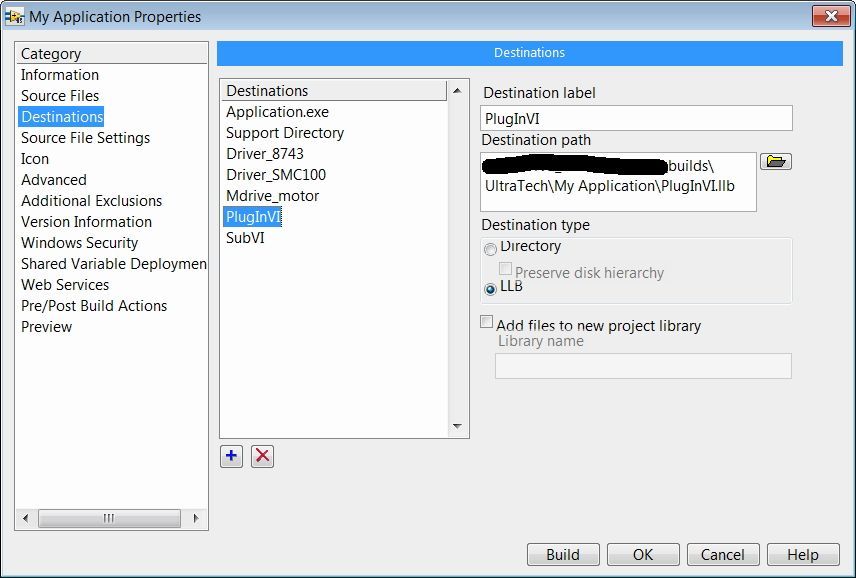

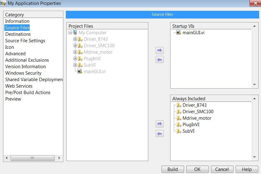

Thank you for all your kindly reply very much. It helps me a lot on improving my LabVIEW skills. I tried your suggestions to build the llb files and it succeeded with below settings. But I had problems when I ran the .exe file.
1. I cannot successfully run my mainGUI.exe because it failed when inserting PlugInVI. After I individually ran plug-in vi with relocate one of the file used in the plug-in vi, I can ran main successfully.
2. All vi in extracted folder from .llb files still have front panel and block diagram even I check the "remove" box while building.
