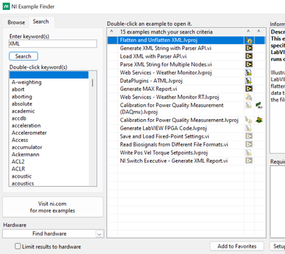

You can find them in the labview example.
your xml is more basic than show in the sample.
