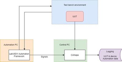

 The schematic above illustrates the setup I have. I would like to know if there is some sort of way to broadcast the signals from LV side and receive it from the CANape side so that UUT & LV data are logged concurrently
Message 8 of 9
(4,133 Views)
Do you know if there is a way to transmit data from LV to CANape via ethernet?
