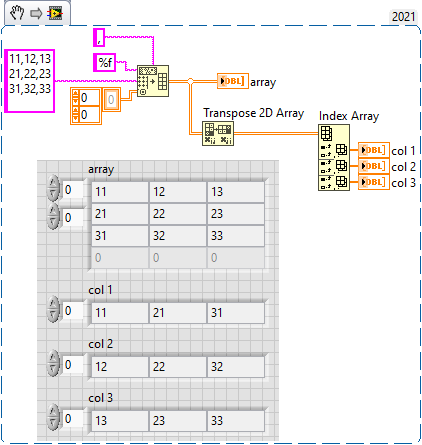

You can convert a spreadsheet directly into a 2D-array if rows are separated by newlines
spreadsheet string to 2D arrayspreadsheet string to 2D array

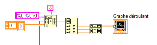

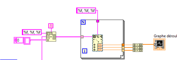

I tried something like this, but I'm getting an error with the Scan From String block:
And I also tried this, but it only shows 0...

@Ouinon wrote:
I tried something like this, but I'm getting an error with the Scan From String block.
In your first String to Array the Format just should be "%s" instead of 3x %f (you're grabbing the whole line as a string)

Even after changing this parameter, I still get the error:
LabVIEW: (Hex 0x55) The scan failed. The input string does not contain data in the expected format.
Message 9 of 16
(690 Views)
How does your input string look like? Can you give a verbatim example? Use probes and indicators to inspect the incoming data.
