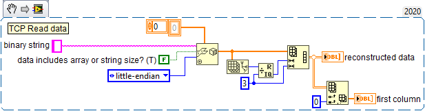

You still did not attach example data. That would make it immediatley obvious that your approach cannot work. If you have binary data, spreadsheet string to array will not help you.

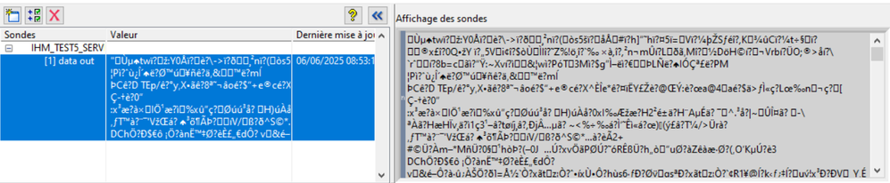

Again: use probes! Right-click wire  -> Probe. Then you will see that TCP Read does not convert data to strings.
A lot of function like TCP Read or VISA Read return strings, even if the protocol is not ASCII based. Use unflatten from string to turn the "string" into the proper data type.
unflatten from stringunflatten from string

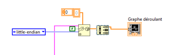

Thank you to everyone who helped me with this issue. I was unclear about the type of data to send because I wasn't sure how I was receiving it myself.
I discovered the existence of probes — incredible tools (thanks Cordm!).
What I receive is a block of 300 doubles in raw data form (every 10 ms):
What I send:  buffer[300] = {0.001, -0.987, -0.456, 0.403, 0.631, -0.765, -0.654, -0.894, 0.002, ... }
What I receive:
I then used Cordm's code with the "Unflatten from String" block, and afterwards, I used the "Decimate 1D Array" block to split my array of doubles into 3 parts.
Thanks to all of you, I was able to solve the question I posted on this thread.
Sorry for reopening it — I thought it was related to the original topic, but in the end, it wasn’t really.
Thanks again to everyone who helped. Here's the final code:
The binary string is the result of a TCP Read. (I'm not showing the rest of the code because it's not relevant to the question, but I can share it if needed.)
