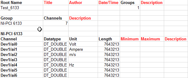

Just another question. When I open the tdms file in excel, there are a lot of cells with no information (see attached screenshot, red text). Is there a way to fill this cells with information?
Thanks.
(4,383 Views)

Post 2: How to fill the possible informations inside a tdms file with text (see picture of posting 2)?
