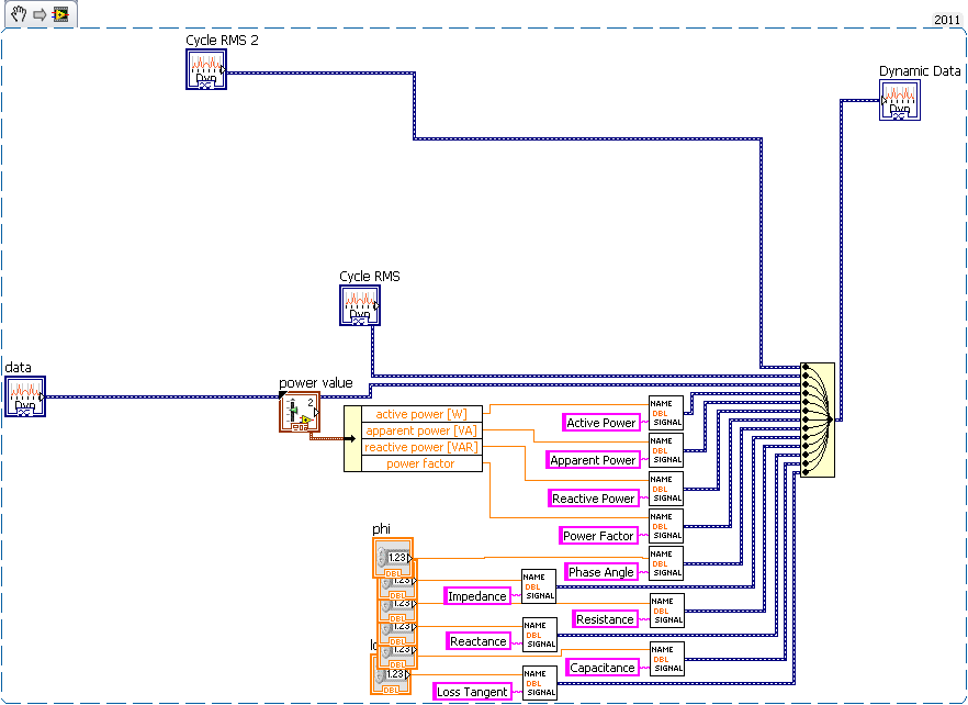

Try this VI I made. It takes in a Double signal and a string, names your signal, and outputs it as a Dynamic Data.
I used this with the Write to Measurement File without any issues!!!
To name a Dynamic Data Signal, use the Set Dynamic Data Attributes VI found in Express > Signal Manipulation
Hope this helps,
Cheers

So why would someone who is using dynamic data (unfortunate person) use your VI instead of the express function? I'm not a big fan of express functions but it does the exact same thing as yours plus the ability to change other attributes.

Right under my picture it says "To name a Dynamic Data Signal, use the Set Dynamic Data Attributes VI found in Express > Signal Manipulation"
I tried using the Set Dynamic Data Attributes VI for a DBL signal but it didn't work. I also tried using my custom VI in a for loop so you wouldn't need multiple instances of it, but I counldn't get it to work. Your more than welcome to try and help with this issue.

The express vi seems to work just fine for scalars. Perhaps you should try it again and if it does not work, post your code.

You are correct. The Set Dynamic Data Attributes VI found in Express > Signal Manipulation worked in the program also. I don't know what I did before to make it not work. Probably when I attempted to feed the VI multiple signals, it started to choke because I did it incorrectly.
This was a good learning experience though. Now I know how to make a Sub VI!
Thanks for the tip
