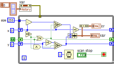

I am creating a program that takes the behavior of a triangular wave and scans in both the x- and y-axis directions.
The x-axis and y-axis are moving between 0 and 255 pixels.
One round trip on the x-axis causes the y to move +1.
After the y-axis reaches 255, it makes one round trip on the x-axis and then 254. how do I make one more round trip on the x before y reaches 254?
I would like to make an addition to the attached program to change it.
I am attaching the program.
I would appreciate any advice you could give me.

I recommend to do a few simple tutorial before continuing.
Also please define words such as round trip in the following sentence:
Can you show it graphically on a 2D plane?
Also please fix the inconsistencies in datatypes and labeling. a wait time is not a "frequency" and zero is probably not a good default. Everything should be U8. You don't need the numeric display is you show the digital display of the charts.
Maybe this can give you a start.

Sorry for the lack of explanation.
@altenbach さんは書きました:
I apologize for the confusing explanation.
The “round trip” is (x,y)=(0,0)(1,0)... (254,0)(255,0)(254,0)... (1,0)(0,0) which indicates a move of 255 in the x-axis direction and 255 back.
When it reaches (x,y)=(0,255), it moves 255 in the x-axis direction and comes back 255. Next, it moves to (0,254) and continues to move in the x-axis direction as before, but now we want it to move 255 again from (0,255) in the x-axis direction and back before it reaches (0,254). Next, we want to move to (0,254) and continue the same behavior as before.
Now: (x,y)=(2,254)(1,254)(0,254)(0,255)(1,255)(2,255)... (255,255)(254,255)... (0,255)(0,254)(1,254)(2,254)...
After Improvement:(x,y)=(2,254)(1,254)(0,254)(0,255)(1,255)(2,255)...(255,255)(254,255)...(0,255)(0,255)(1,255)(2,255)...(255,255)(254,255)...(0,255)(0,254)(1,254)(2,254)...
The waiting time has been changed to 1 by default.
Thanks also for the advice about the digital display of the chart.
(485 Views)
I want to traverse a 256 x 256 space one element at a time. We intend to get data at each location. We intend to move from adjacent element to element at a uniform speed (about 300μs).
Thank you for your kind reply.

I did a quick modification during breakfast. See if this works for you.
(448 Views)
Thank you for your reply.
I tried running the program.
The “round trip” movement is the same as I had imagined.
Thank you very much.
However, with this movement, Y returns to 0 after reaching 255. I would like Y to decrease to 0 after reaching 255, such as 254...253...252...
The program I attached also does this.
Here, after reaching 255, I want it to decrease to 254 after two round trips, not one.
If possible, I would appreciate it if you could modify the program I attached earlier.
This is because I plan to set different scan ranges for X and Y, such as 10,000 pixels for the X-axis and 256 pixels for the Y-axis.
(428 Views)
