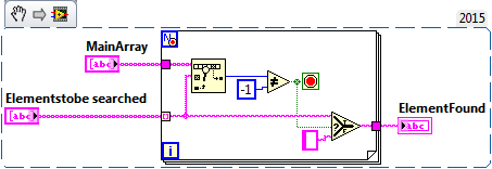

Try this which will give the first found element if found, else empty which means none of the elements found
