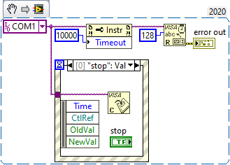

I don't want to get into a Bytes at Port discussion, but the statement above should have a caveat.
The VISA READ will immediately return with an error if VISA Close is executed. However, the VISA CLOSE will not return anything (like an error wire) until the end of the timeout. So now the VISA Close blocks execution of subsequent code.
See the crappy example below.
