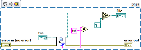

I am extremely new at LabVIEW programming and wish to implement a basic read file from text file.
So far I have this set up:
I got the compound arithmetic function to output true for both conditions, but I am confused as to how with that boolean condition to make the program pass along the file.

Sorry I wasn't clear with my first post.
What I meant by "as to how with that boolean condition to make the program pass along the file" is when a user selects a file from the browser button, my program will check if it's an existing file and also if it has the right extension (which is a .txt file), if both conditions hold true, then the program will continue with that file and pass it along to be used for other functions.

@TeddyLu wrote:
I got the compound arithmetic function to output true for both conditions, but I am confused as to how with that Boolean condition to make the program pass along the file.
Does the program in need of, checks for extension file to be .txt file (in this case) and passes only files with such extensions..?! Am I clear..
If so, you can achieve the same with above code..

Hi Teddy,
Using the FileDialog ExpressVI you can configure it to select only existing files and you can provide a file pattern (like "*.txt") to only show files with correct suffix…
(It's not fool proof, but will help a lot!)
So you want to implement something like
IF statement THEN do something
IF-THEN-ELSE usually is done in LabVIEW using a case structure…
(7,210 Views)
use a case structure and pass the path if the extension is matching and use scan from string function might help you in the spacing problem

In case of state machine based on the Boolean case can be selected.
