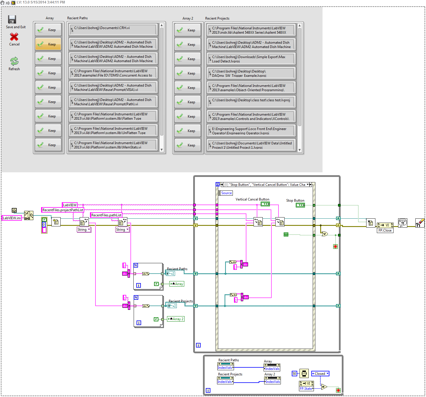

Oh Fine
Supplied as is modifiy as desired don't blame me for messing with your ini
Assumptions: you have not changed the default directory <LabVIEW>
Message 5 of 19
(10,460 Views)
I'd replace the bottom loop by some dynamic event registration of Mouse Down and Mouse Move Events to track usage of the scrollbars in the main loop, plus a "Panel Close?" case to quit nicely and replace "recient" by recent" but otherwise, that'll do the job.
Readers, please go an Kudo the suggestions linked to by crossrulz

The point being, it takes 15 minutes to roll your own.  Since it wasn't a billable project the demo POC is all I cared to take time off to do.  But, it comes up often enough that the demo was warented.  I'm sure VIA would puke all over some of it (like spelling)
