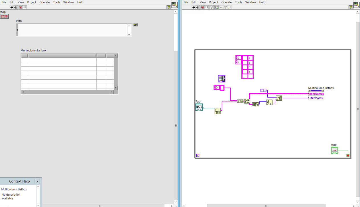

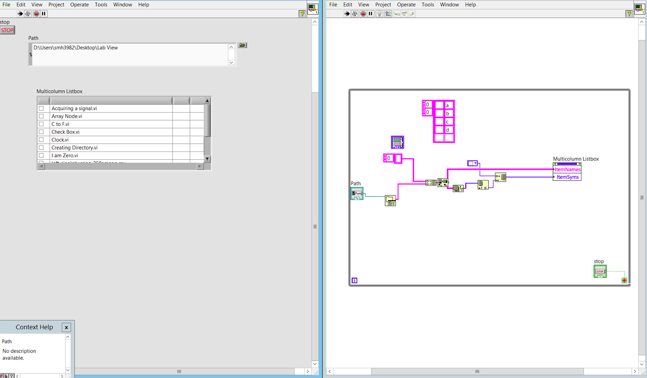

Hello, This new topic/issue is based on the previous two problems. that I listed In the URL. I have attached 2 steps pictures here of parts of my project. I have created directory path, in a way that you just select the folder and it will show all the files in that folder in list format. You can also see that I have check boxes there. My problem is even though I have check boxes I don't know how to check them off when it's running and also is there any way I can Highlight the files in the list and double-click to activate/operate them? I am using Labview only for 4 days. Any type of help will be much appreciated. Screen Shot 2017-06-15 at 9.11.02 AM.png

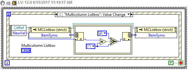

Those are not real checkboxes, but rather pictures of checkboxes.  When you click on a row in the listbox, you need to have an event that will get the value that was clicked and update that index with the appropriate picture of the checkbox that you want to show.

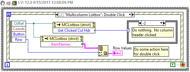

Add another event for the double click action on a row of data.  I know you didn't mention anything about the column headers but if you double clicked a header (maybe for sorting, etc), that event can be captured here as well.
Edit: The clicked column header would more appropriately go in a Single Click event but you get the idea, I hope.

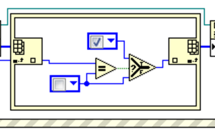

Thank you very much. sorry for my lack of knowledge but How do you make this box? And how do you get 'ctlref' and 'NewVal' in event structure? Screen Shot 2017-06-15 at 2.14.39 PM.png

That "box" is the In-Place Element structure on the structures palette.  Right click the border of it and select Add Array Index/Replace Element.

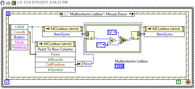

This is So Awsome! I am ever grateful to you!! It's working great. Just one question: I think you cannot continuously click on a row to check on and off. Once you check on a row you have to check on another row and then you have to return back to the previous row to check it off.

That's because the event is setup as a value change event.  Clicking a row that is already selected doesn't trigger a value change event.  If you change the event to a Mouse Down event, then you can use a Point to Row Column property node to get the row that was clicked (whether the value changed or not).
