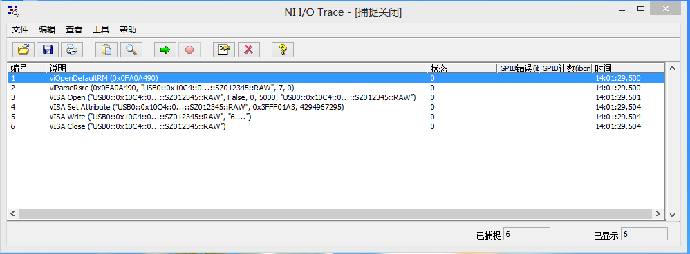

SRB fail:
Message 14 of 16

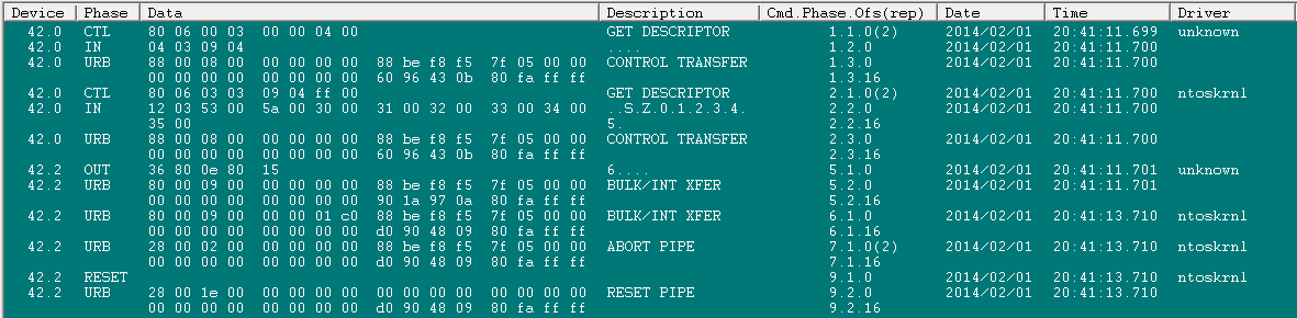

Hi all,
I can write no error now, but I still need to wroking:

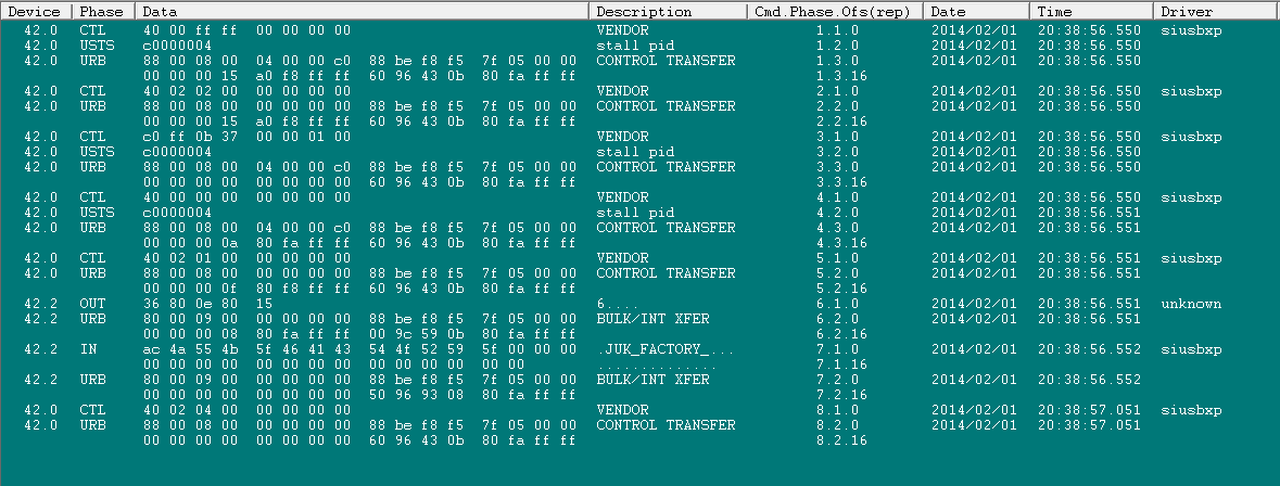

Dear all,
I can read SN in LabVIEW now with CTL as picture.
Boone
