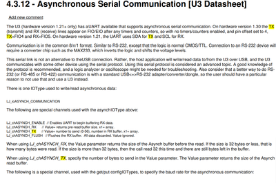

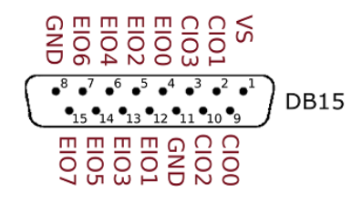

   I tried to Configure TX and RX as EI05 and EI07 respectively in LabJack U3-HV .But I can only some other  pins as Tx and Rx.Kindly help!!!

U3 HV Labjack has a UART that Support Serial Communication.I need to transmit data from EIO5 and receive data from EIO7.

It is not possible to configure any arbitrary digital IO for Asynchronous serial on the U3. The TX and RX pin must always be adjacent pin numbers. Additionally, the TX and RX lines cannot appear on either EIO6 or EIO7. Suchithra@29 provided a good capture of relevant documentation. That capture was from the following page on our website:
https://labjack.com/pages/support?doc=/datasheets/u3-datasheet/4112-asynchronous-serial-communicatio...
As described there, the Asynchronous serial feature TX and RX lines appear on FIO/EIO after any timers and counters. That is controlled by the TimerCounterPinOffset configuration, which must be 4-8 on the U3. You can find related details in our Timer/Counter documentation and the related pseudocode:
https://labjack.com/pages/support?doc=/datasheets/u3-datasheet/29-timerscounters-u3-datasheet/
https://labjack.com/pages/support?doc=/datasheets/u3-datasheet/416-timers-counters-u3-datasheet/
For example, if you do not have any timers or counters enabled and the TimerCounterPinOffset set to the maximum value of 8, The asynch TX line would appear on DIO8 (EIO0) and RX would appear on DIO9 (EIO1). If you had both timers and both counters enabled and TimerCounterPinOffset=8, TX would appear on DIO12 (EIO4) and RX on DIO13 (EIO5).
