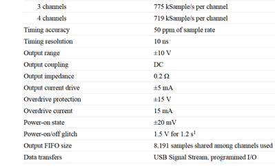

Can I apply power supply from DAQ by connecting 4 and 6 pin to the one of the analog output port?
(4,157 Views)
In short, no.
The voltage levels on an analog output are suitable but the maximum current is much too low for your sensor.
GCentral
(4,152 Views)
I checked on specification of the DAQ (Analog output ) it shows output current +- 5mA
and limit for the sensor is 35mA
(4,145 Views)
Accepted by topic author mi1111
The DAQ value is a maximum. The sensor value is a requirement. You need at least that much.
You can if you need supply the positive value from the DAQ board via the +5V output, which can source 1A, but you have no negative supply.
GCentral
(4,140 Views)
Hi mi,
That's not a "limit", but a requirement!
Use an external power supply!
