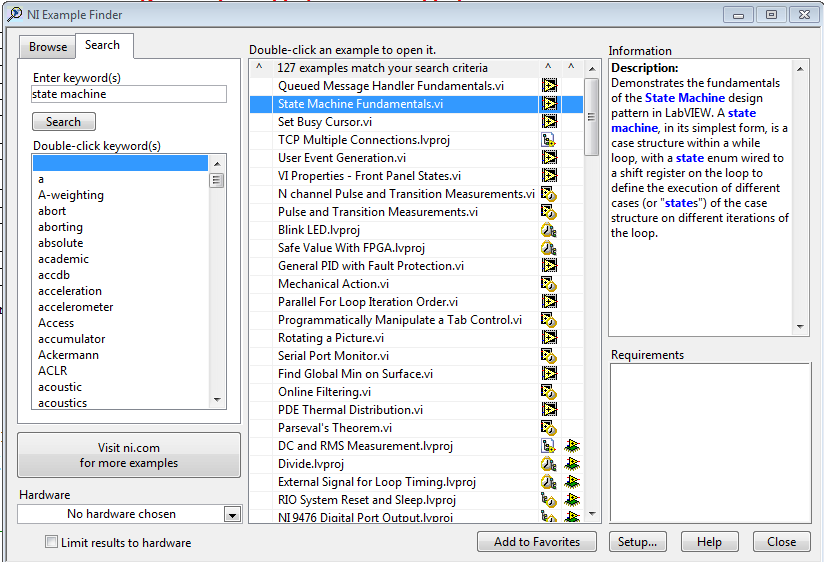

There is an exampl of the state machine in the LabVIEW examples:
Message 6 of 12
