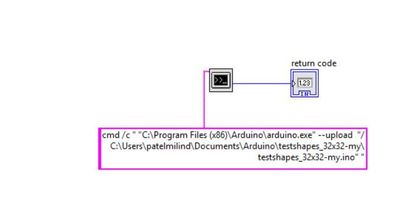

By using the System Exec VI into the LabVIEW, some how I am able to load the written arduino code.
But, It is taking long time while it opens the arduino.exe each time and then upload the programme every time when I runs the VI.
Message 12 of 20
(1,892 Views)
You are using the command line version of the Arduino IDE to upload Arduino code into the Arduino.
You still would have to program in C/C++ for the Arduino and write working Arduino code  *.ino  if you want to do that.
If all you wanted to do was do that, you should have said so in the first place.

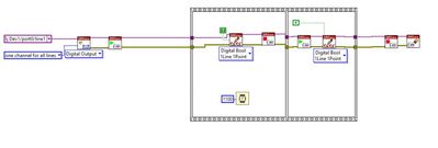

I programmed arduino to read the pin number 0 whether it is HIGH or LOW
and then I wrote in a way that if pin o is HIGH then perform specified operation if Low then perform the specified operation.
then I used Ni DAQmx to give HIGH and LOW value to call the arduino by giving HIGH(1) and LOW(0).
Thank you very much for help and support
Message 19 of 20
(1,825 Views)
That's the definition of a Rube Goldberg machine.
